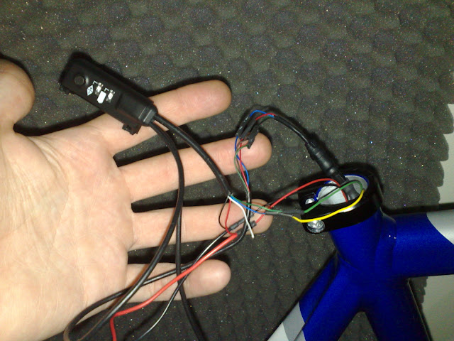

this is where the magic happened
4 wires to RD, including those soldered battery cables
4 wires thru original connector to gear switches, 3 on use
all done like in page 1 schematics
doing it wrong?

Postby Jeffr » Sat Jan 29, 2011 12:31 am
You can press the buttons at the same time. Electrically it is not a problem.
I can't see the colors and wires well enough to tell if you have a connectivity problem. Up shift and down shift go on the same RD wire. Should be green, I think. White should go to the fd shifter. Blue goes to both.

Postby Jeffr » Sat Jan 29, 2011 7:55 am
I see, I looked one page back, sorry. Your own. You may simply have them connected improperly. There is one voltage source and three different button wires. You simply connect voltage to any button wire momentarily to trigger it. It doesn't matter if more than one button is connected simultaneously. They're all inputs except for voltage.

Postby manninen » Sat Jan 29, 2011 8:00 am
this is how it´s connected
correct me if i´m wrong
connected like pritchet74´s shimagnolos

Postby manninen » Tue Feb 01, 2011 12:00 pm
ok, it works!!
somehow i blowed my front cable set/or it didn´t work as new (my best quess is static electricity)
just bought a new one and installed it
-battery condition information comes from FD
-you can press both up/down switches at the same time with out breaking anything
