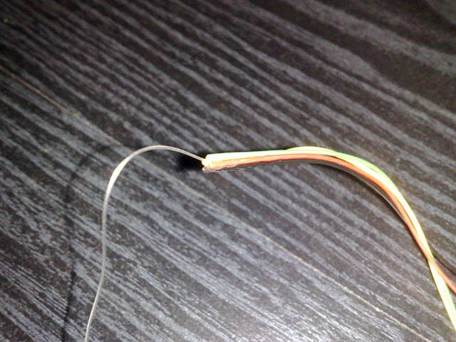

drill it thru inside tube
old phone cable, fishing line and super glue
voila! 8)

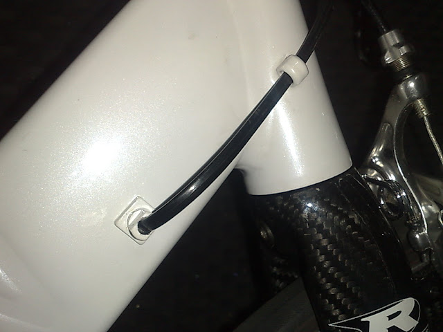

Postby Mike K. » Mon Jan 10, 2011 2:25 pm
Manninen very clever entry point for the wire. :)
Mike K.
Cat 1
Posts: 316
Re: DIY DI2
Postby manninen » Mon Jan 10, 2011 3:25 pm

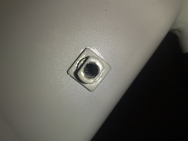

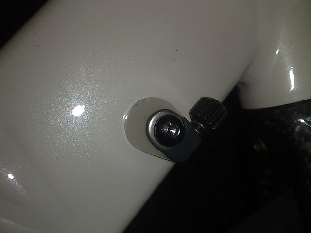

Mike K. wrote:Manninen very clever entry point for the wire. :)
:) threads are still there
i have to drill larger hole to chainstay to get wires out :(
