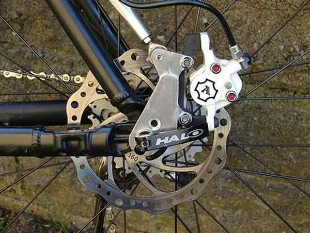

The brake caliper looks like this:
There is 73mm center to center between the holes
I have this bracket to put on the caliper:
I just not sure I can use this...
I realize that there is a solution that look like this:
http://www.supercycles.co.uk/site_detai ... ductID=333
I really don't like the looks of this very much, but if that's what it takes, I will be willing to mount it.
Is there another way, or do I have to mount this badboy?

I guess this is what I need - thank you, CYCO...

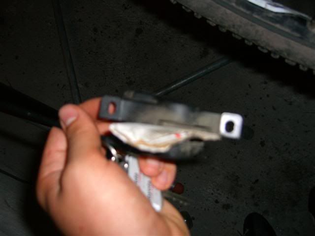

Hi KF,
I realise this reply may be a bit late! However i have this if it helps...
The one on the bike has washers for packing and just kisses the weld. The new revised one has the extra packing built in with extra clearance for the weld.
The disc is a 185 dia as the triangle is too small for anything smaller!
Hope this helps :D
