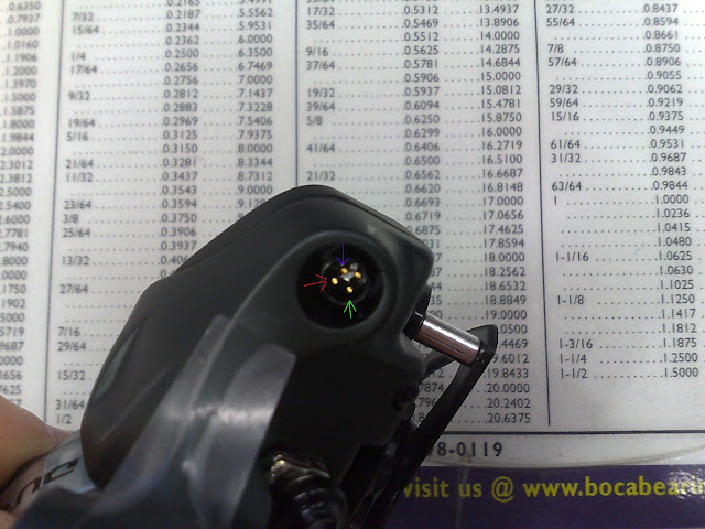

Postby manninen » Mon Jan 17, 2011 10:13 am
manninen wrote:picture to that hole and which pin is which :)
if someone else want to save ~20€

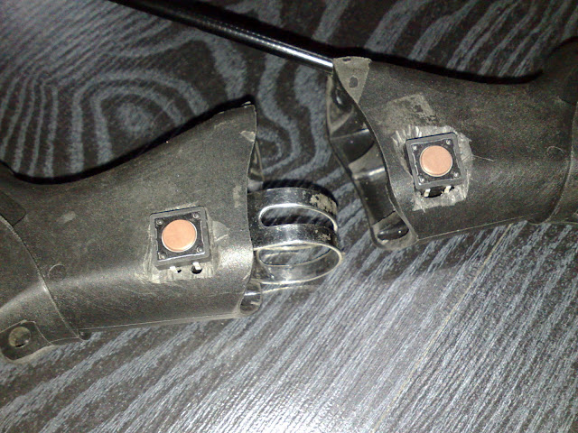

Postby manninen » Wed Jan 19, 2011 7:37 pm
left switch went little bit out of hands but nothing that little bit silicon couldn´t fix.
they stay under the hoods, right side goes upshift, left downshift

Postby skimons » Thu Jan 20, 2011 11:34 pm
haha, cool! what kind of levers are that?
