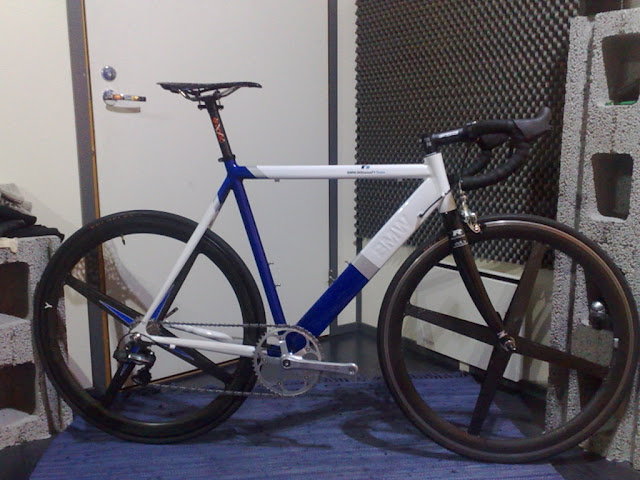

ok, fully build pics
nobody respects, dont´t really care much. i built only humorous bikes
q-factor 137mm, can´t go much narrower
gonna sand down those horrible tribals from seatpost and maybe rear wheel brake contact

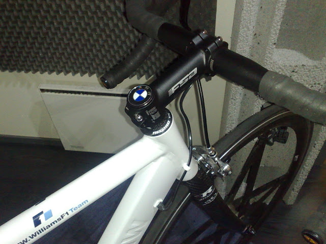

Postby dunlinii » Wed Feb 02, 2011 9:43 pm
That loks super clean. Love the wheels on it, and the BMW theme. Did the topcap come with the frame?

Postby manninen » Wed Feb 02, 2011 9:52 pm
frame is bmw Q8.r, and top cap belongs to that bike. bike has been usually with dura-ace groups but i´ve seen with campa too.
depends yearmodel

Postby Boonen » Fri Feb 04, 2011 9:47 pm
Long time ago I've seen those wheels :D Did you take off the rear brake track yourself or was there a version with a carbon brake track?

Postby manninen » Sat Feb 05, 2011 12:26 am

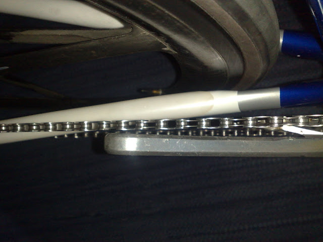

yes over 2tons of wheels, not so popular in 2011. have to be 1-1.4tons
not so hilly sections here so i just enjoy riding without truing wheels, i´m happy with these
just painted brake track
daaaamn dat di2 is so smoooth! :applause:
