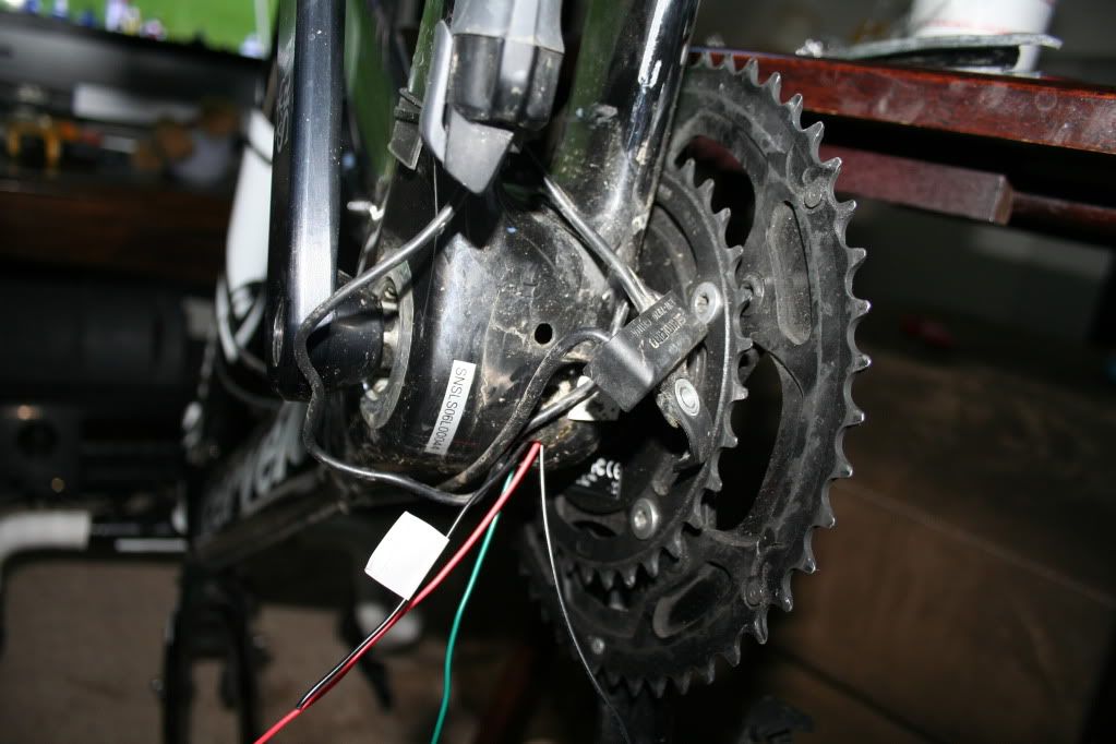

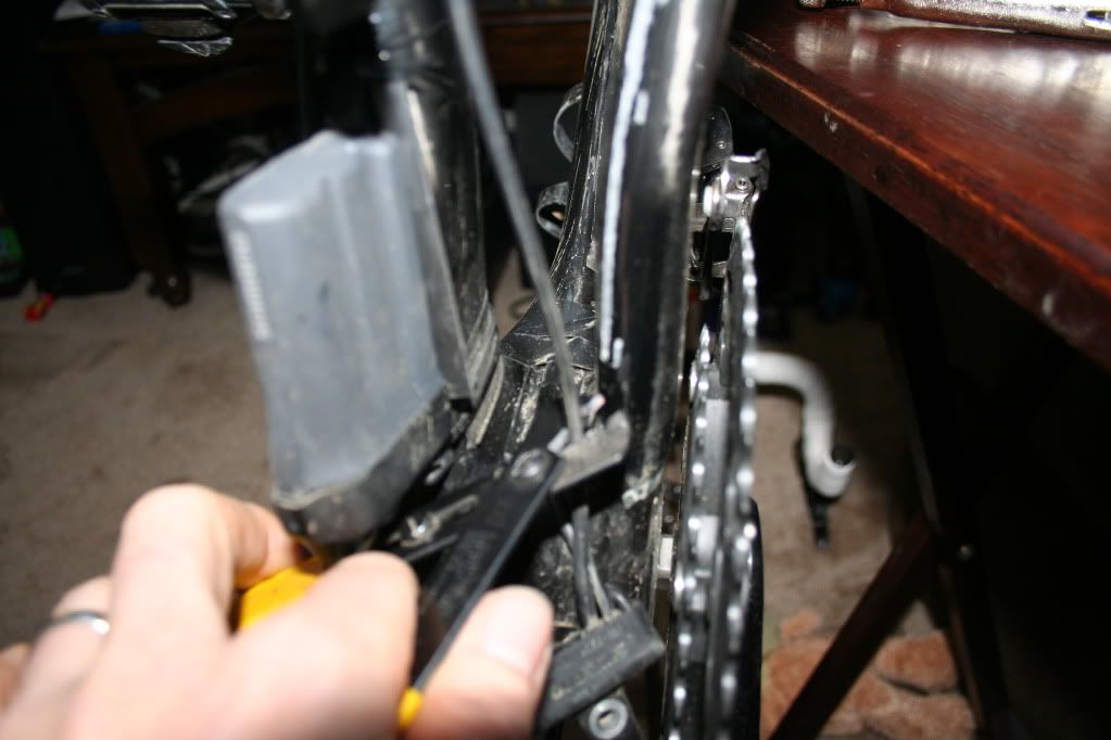

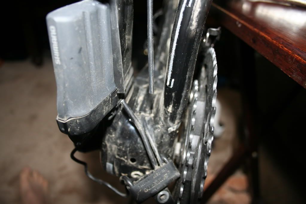

Taking the RD cable is step #1:
More to come......

I've got pictures showing this step to completion, but I didn't have time to post 'em. That cable is complete & it works perfectly. It's so clean now!
Next step is either the front derailleur or the shifting cables. I haven't decided. Next week I'm flying to Denver to get some assistance with modifying the battery to take that internal as well. :mrgreen:

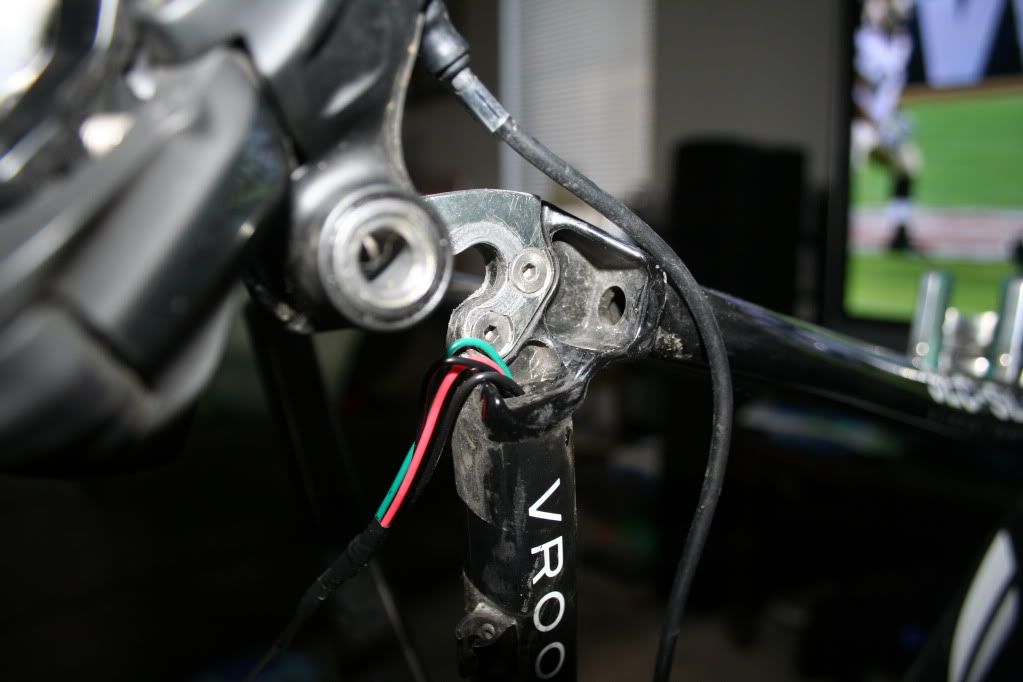

Those are my own cables. When I cut the cable to the RD there just wasn't enough wire length to work with to make the splice once I ran the cable thru the frame, so I used other wires. When I do the shifter wires there should be enought that I don't have to use other wires. I'll find out soon enough.

I'm going to drill a 5 mm hole in the top tube similar to the holes in the newer S2 & S3 models. But that hole needs to be within 10 mm of the headset. Those instructions are from Cervelo & drilling this hole will NOT void my warrantee. Pretty cool, eh?
